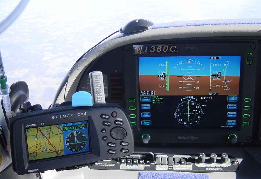

I’m also getting addicted to numbers like those below, on my descent from 13,500 into Chapel Hill a couple weeks ago (albeit with an almost 50k tailwind):
I’m NOT putting the SR20 down! It’s a WONDERFUL airplane. It’s just that moving from my Tiger (0-360, 135+ kts) to an SR20 would have been an incremental increase in performance. The SR22 is more an “order of magnitude” increase.

You have every right to brag about your plane’s performance, but showing a picture of a 235 GS loses some of its luster in a 600FPM descent.
