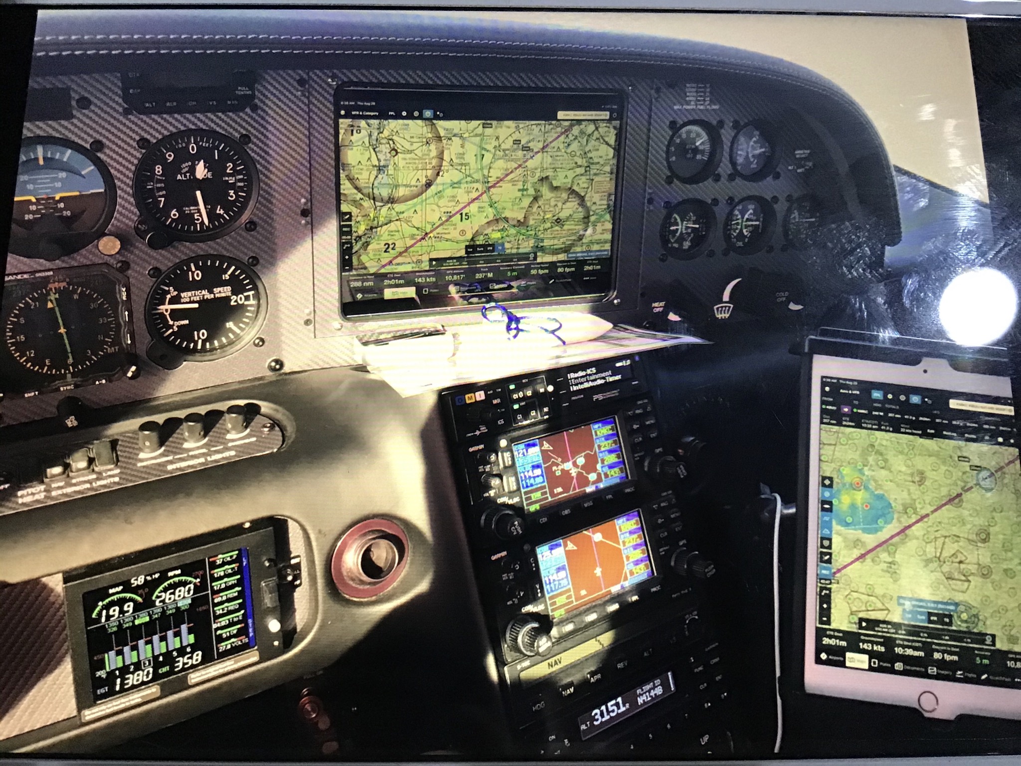

The simple answer is to put an iPad in its place. Remove the MFD, replace it with a flat plate with an iPad holder, then have a USB power outlet installed (can use the now-redundant MFD breaker for power supply) along with a BlueMAX engine/Bluetooth interface. Run the BlueMAX app and whatever other aviation apps on the iPad you like. These are all minor changes (the analog gauges or the PFD engine data remain as primary engine instrumentation.)
You won’t get Stormscope or Skywatch data on the iPad with this setup, but those are still displayed on the 430s.

Yes except the iPad “mount” is really just a plug-in and therefore no approval is required. However, be prepared for an iPad to shut down on a hot day or in direct sun. My MFD never did that.
Ok, the PFD is an EXP5000, and like others have said replacing it would require an STC, or a 337. However, the PFD is still able to be maintained, albeit at fairly high repair prices, so it’s not an immediate problem. And the PFDs have proven to be pretty reliable, more so than the MFDs.

I added impingement air from my fan manifold to the back of my “in panel” ipad mount and I have never had a problem…and I have houses in both the Dallas area and south Florida!..not a big deal to do and it pretty much makes the ipad mount bulletproof!
Hey guys. Same issue here. I have the ARNAV unit in the plane I am buying but on the bright side, I have the aspen 3 pack with the pfd and 2 mfd’s and synthetic vision. So, my intent was to replace the arnav with an ipad from guardian avionics and then also get the JPI engine monitor. Any thoughts on this setup and where I could get this work done?
Steve,
When I installed my iPad in place of the ARNAV, the Guardian Avionics unit was not available, but something similar was from Sporty’s…The Guardian unit is better thought out and should work fine, but it will not yet accept the iPad Air3. It will handle the Air1/2. I had all of this work done by Sarasota Avionics. Talk to Ryan Van Kirk at 941-544-3882 (cell). He can do it in Sarasota, KSRQ, or up at Tampa Executive Airport, KTPF.

Sorry also that’s the JPI 850. Not certified so have to keep the factory gauges also. If I did it again I’d do the 900 so I could remove the factory dials
