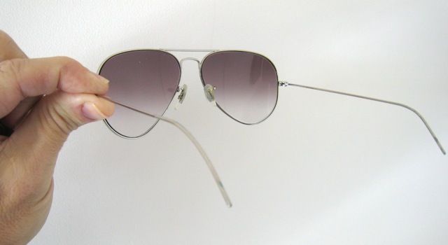

Yes on the sunglasses. They are progressive prescription so need to be correctly placed for me to see anything in the airplane.
Sherri, what do the temple pieces of these sunglasses look like?
You know the plastic pieces that are on the “ear” end of the earpieces that sit on top of your ear? Superfluous. They usually pull right off. Then all you have is a ~ 0.05" thick wire “frame” between your head and the headset ear cushion.
You want them to look like this:
Check your earpieces to see if they pull off. If not, get frames so you can do so. HUGE difference in comfort.
