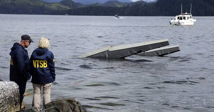

A great friend of mine also crashed and died there several years ago. Guess what… He was OVER GROSS! (And with an FAA DPE on board, sad)
This airplane was 100# over max gross according to NTSB analysis :
It was 100 degrees at time of takeoff. The calculated density altitude for Cameron Airpark at the time of the accident was 4,125 feet MSL. There was a wind shift in play as well. But the point is that even at “only” 100 points over gross, you can get in deep Bandini.
Agreed, but there’s always a wind shift there and the temperatures are in that range quite often. Point is, it can work out … until it doesn’t one day … and that video had an impact on me so thought it was worth sharing.
