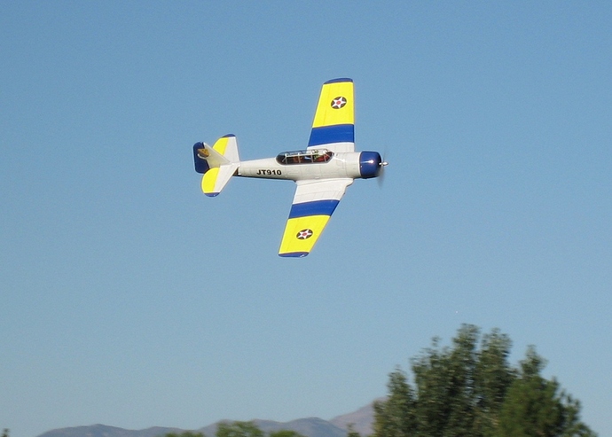

YELLOW with thick accent lines in black or dark color for contrast. This comes from many years of flying ( and trying to see ) RC airplanes.
Gordon,
Well, since that time, the Navy, at least, has pretty much stuck with these kind of color schemes for its training planes:
I’ve casually chatted with Ross about someday doing my bird this way, but with the “F” tail code and markings for the Training Wing in Pensacola, my “home” Training Wing and where I earned my wings. Downside is that “unique” color schemes can sometimes have a penalty price when the time comes to sell. But hey, who wouldn’t want a “T-53B”?[H]
