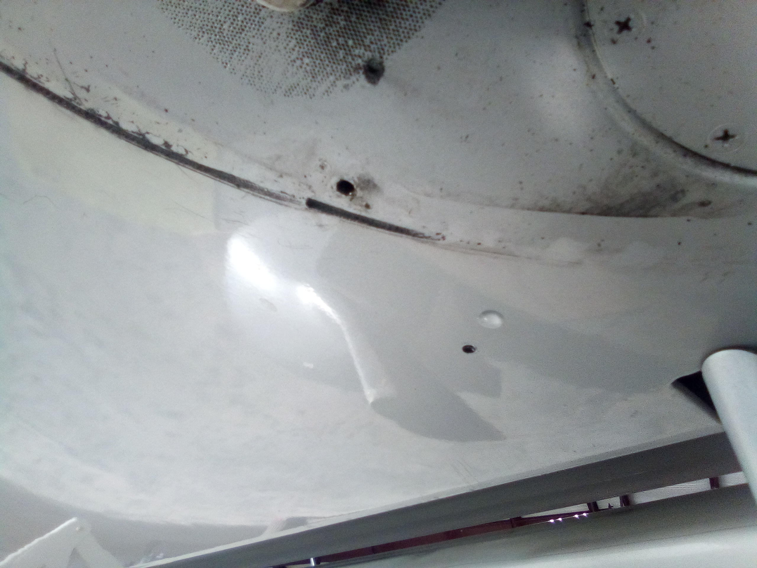

Wing damage from landing gear fairing
During a pre-buy inspection on a 2012 sr 22 T GTS, we located a groove on the lower wing located around the landing gear fairing please see attached picture The friction between the fairing and wing exposed the fiberglass. Has anyone else had this issue ?
That’s normal for the type.
Alexander, thank you for your response. I am concerned because it is the structure where the landing gear is supported. How many times have you seen this?
If you would like answers to your question you can search the issue which is fairly common and you’ll get more responses on the member side.
