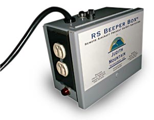

It is easy enough to have the local FBO plug it in for you prior to your flying, but can be cumbersome if you fly early or at odd hours. Alternatively, one can buy a “beeper box” (Mountain High Technologies) that turns on remotely via a pager in the “box”. The latter is what I did and it works well and gives me more control of engine heating on and off. Cost isn’t bad considering the mental grinding one does worrying about starting cold soaked engines.
I would like to know more about this “beeper box” methoed , including cost. You can post it here or email me at sekharan@netexpress.net
Thank you in advance.
Raj
Raj,
http://www.reiffpreheat.com/Beeper%20Box%20pg%201.htmClick here for information on the “RS Beeper Box” from Judith Mountain Technologies.
