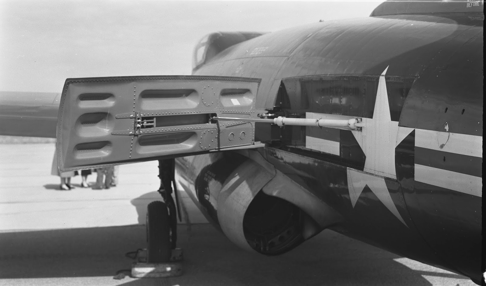

And throw open both doors, and hold them in the most open position. Speed brakes are a wonderful thing.
