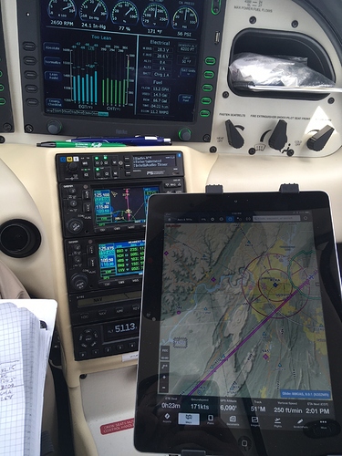

More tinkering in the hangar this weekend. Here is the goose-neck iPad mount I came up with. I can’t figure out how to rotate the picture, sorry.
Start with this vehicle iPad mount from EBAY, designed to bolt onto the seat belt mounting point of a car or truck. Unscrew the mounting hardware at the bottom of the gooseneck and just throw it away.
Then attach this boss clamp from Amazon to the seat adjustment bar on the passenger’s seat. Use either side of the clamp, it doesn’t matter. Place it as far to the left as possible. It screws on solidly in a few seconds. Do not over-tighten. Don’t buy a flimsier boss clamp - the screws strip easily. Beware also- not all boss clamps are large enough to accept the 11/16" seat adjustment bar.
Then insert the plastic covered metal base of the goose-neck into the second opening and tighten. Make sure not to insert the gooseneck too far. The screw of the boss clamp has to be in touch with the metal base, not the flexible part of the goose-neck.
Done. Total time 5 minutes. Total cost about $30.00. The nice thing about this system is that the iPad can be tilted, turned or pushed out of the way in an instant.
I can’t recommend that setup. Almost all goosenecks are just not stuff enough to mount an iPad. It’s too heavy. Unless the neck is super short. In your case here the neck can instruct the power / mixture of it were to droop down. Maybe your set up is super firm? I’ve tired 4 or 5 different mounts just like that and they just don’t do the job. There is one that super thick and is pretty firm but it just doesn’t beat the ram single mount setup where you can stick it to the left and over the yoke. It’s like a 3rd screen. You can either use two suction mounts (one for the window and one for the device) or get an iPad mini mount. Both work well.

I haven’t flown with it yet, but hope to next weekend. I think it will be strong enough. Years ago, in my last Cirrus, I had a very useful and strong goose-neck mount for a Garmin 396 that I welded to a very small vice grip. The 396 is heavier than an iPad, I think. The vice grip worked fine as an attachment point for the seat adjustment bar. This was years ago, before using a mount that a Copa member came up with for the 396.
Flew this weekend. There was mild turbulence from Birmingham to Knoxville. The mount worked fine on both legs of the trip. The mount was easily reached by my right hand, which made it easier to work the iPad with the forearm resting on the console. For landing and takeoff, I just pushed the whole thing over to the right , out of the way.
