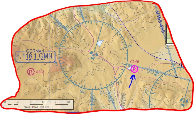

I’ve noticed the odd METAR flag showing up where I thought there was no airport. One place I’ve seen this is near the Gorman Pass in Southern California. When I looked at the chart closely, I noticed a special use airport, Quail Lake Skypark (CL46):
I doubt there actually is some reporting coming from this station, perhaps it is from some other airport with incorrect lat/longs. I know that some passes in Colorado now have ATIS broadcasts, but I’m not aware of anything in California.
I have found a couple of places where there is no airport but I get a weather metar. I am pretty sure that this is a weather reporting station, and even has an identifier, but the identifier doesn’t have any way to show on the MFD. I have also seen these metars on DUATS, etc…
