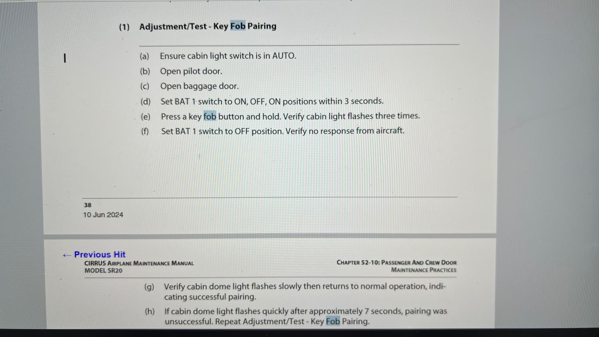

Friendly note: A common problem seen with the new style key fob is the clip that holds the battery down inside the remote breaks free from the circuit board which prevents the fob from working. The first thought most people have is to pair the remote again, but often the clip inside needs to be resoldered to the board. If you do need to pair the remote again, the procedure is in the aircraft maintenance manual chapter 52.
