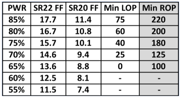

So unless i am completely off base (which is possible), this is what i do… i am WOT, at 9k’, which is 75-76% of power, then i lean to 15.6GPH per the COPA FF Cart… i thought that was/is LOP? Do i misinterpret the chart?

From the chart’s SR22 column and APS LOP formula for power: FF 15.7 x 14.9 (LOP constant) = 233.93 HP / 310 Max HP = 75.5% power.
It appears to indeed be a LOP setting to me…although I personally typically have not been flying LOP above 65-70% power.

15.6gph / 9000 feet / 76% power are simply an impossible combination of values.

Brian, thanks. Glad to hear its OK. In fact, i used the COPA Lean of Peak operations guide you gracefully shared with me during one of our most recent flights.

So flying at >6k’, my RPM should be, according to this doc, at 2700 RPM, which for me is 2670. THEN i lean to 15.7 per the table, which gets me to approx 75%, 170KTAS and hopefully (!) LoP.
