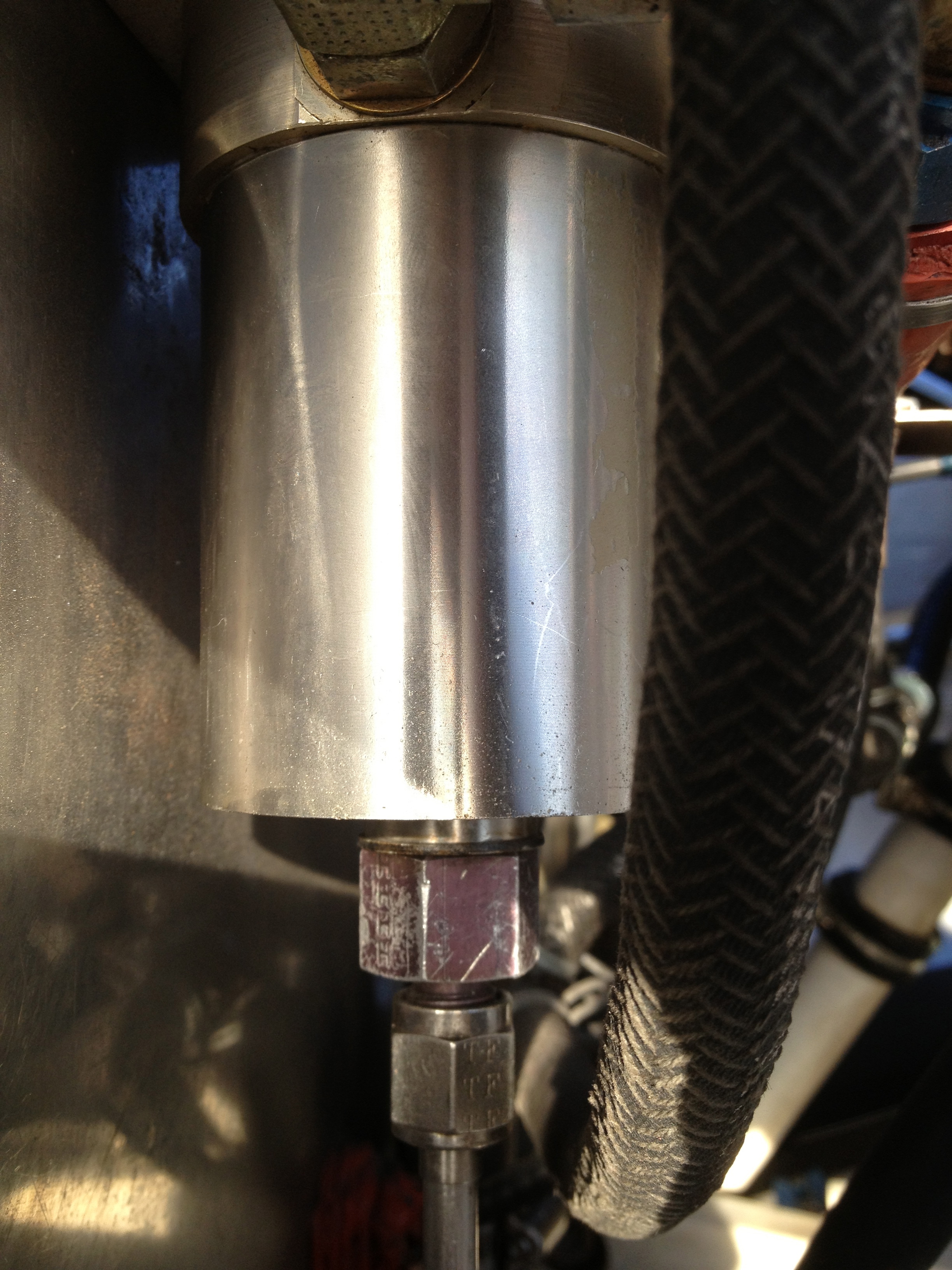

We plan to leave at 7:30, but I go to the airport at 6:30, to begin. The oil and gas overflow tracks look OK,
(thank goodness I cleaned the belly yesterday AM, Mom’s very particular about fresh unnerwears when hospitalized), send the photo to Jim, decowl, tighten the gascolator nuts with the 7/8th wrench that Jim (smart alec) instructs me to look for under the right cowling, by the number 1 battery, where, you guessed it, I’d left one (OK, OK, 3) just before having Jim inspect the plane the first time… well, OK, 20 hours before. This is how he knows me.
He leads me through the hoops- things that’ll kill you first, then less worrisome stuff that could cause a CLUNK.
The gascolator O ring is intact,
There are no leaks, expert sumping already ruled out water in the fuel. Boost pump and prime do not cause the terrific leak we all saw in Jim and Roger’s scary movie. The ignition leads were just right tight. On to a full rich mag check at 1500 rpm, L=R at 1460, which is good…
Next check the farings, and a creeping L main injury actually looks a little worse since the last time I paid attention. I feel a little guilty- Bryan Heitman recently said you can tell how much somebody loves his plane by looking at the farings…ouch.
Dan Pace is on the field by now, and has “speed tape” (that’s Northernspeak for white duct tape). We apply a couple rounds to the faring,
get Jim’s blessing, amidst a scolding for not having engine data already downloaded on a thumb drive to email him at 6 in the morning- a stern Dad, our Jim…and take off.
And wallah!
Not a peep in the four hour flight to Port au Prince. No CLUNK!
